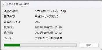

a month ago
>What happens if you don't specify the fileTypeID? The code should be able to derive that from the file extension.
In this case, "err = ACAPI_ProjectOperation_Open(&fop);" will return "APIERR_BADPARS" and nothing will happen.
If "APIFType_IfcFile" is specified, a progress dialog like the one in the attached image will be displayed and the "open" operation will proceed partway, but ultimately the error "-7003" will be returned and the "open" will fail.
