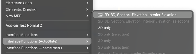

I've just trid it on macOS with the Archicad 29 SDK, and it works for me.
I added the MoreOptions_16x16.svg icon from DG_Test to the Interface_Functions/RFIX/Images folder, then modified the Interface_FunctionsFix.grc resource:
'GICN' 32222 "More options" {
"MoreOptions"
'STR#' 32501 "Strings for the Menu" {
/* [ ] */ "Test"
/* [ ] */ "Interface Functions (AutoState)"
/* [ 1] */ "2D, 3D, Section, Elevation, Interior Elevation^ES^EE^EI^E3^32222"
After building the add-on, the icon appeared in the menu:
Could you please check this?
Best, Akos

This setup works for me as well (I tried to outline a very similar configuration earlier). However, in the example you described, I would like to assign an icon not to the "2D, 3D, Section, Elevation, Interior Elevation" command menu item, but to its parent sub-menu item: "Interface Functions (AutoState)".
There are also precedents for this in the factory Archicad setup. For instance, take a look at "Design/Connect/Triming bodies", or "Files/Interoperability/IFC/IFC Project Manager"... — in these cases, the bolded menu items already have icons assigned to them. I assume that the icon associated with the Connect menu item is handled internally, whereas the icon assigned to IFC should be coming from an add‑on.
