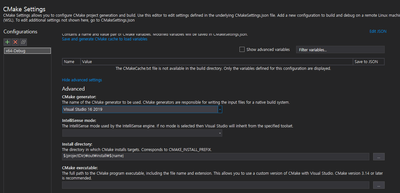

Hi Lee,
You are using some incompatible settings with your CMake generator.
I had the best success with using "Visual Studio 16 2019" or "Visual Studio 17 2022" generators instead of the "Ninja" generator.
Here would be the option if you are using "CMakeSettings.json":

LeeJaeYoung
How can I access your cmake settings?
ā€ƒHow can I access your cmake settings?
genenate is not included.

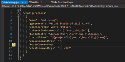

In settings, the following settings appear.
ā€ƒ

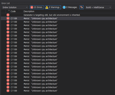

LeeJaeYoung
I set up what you asked me to do.
Even though I reinstalled it... ^^
I came across these errors:
I want to know what the problem is.
This file was also compiled in archicad 26.
Why does archicad 27 produce this error message?
I need your help.

Solution
Things change between versions, and a lot of things depend on whats currently installed on you machine etc.
From the errors you get I would specify the following (in the CMake Settings I mentioned in my previous command):
  • CMakeGenerator: "Visual Studio 16 2019 x64" "Visual Studio 16 2019 Win64"
  • Toolset: "msvc_x64_x64"
  • maybe also add the following flag to CMake command arguments: "-T v142"
Edit: Fix actual generator to use.
Automating Archicad with Add-Ons, GDL-Objects & Python Archi-XT.com

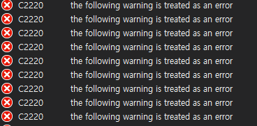

thank you
With your help, I was able to study API. ^^
Because compilation failed due to the warning of C2220, I compiled by deleting /WX as shown in the picture below.
Q1. Is it right to do this?

Glad I could help!
Yes that works. Alternatively you could keep the /WX flag and disable this specific warning with adding the flag /wd2220.
@LeeJaeYoung wrote:
I didn't have x64, so I chose win64.
That's the right one! I mistyped it.
The "-T v142" should maybe go to the "cmakeCommandArgs" instead of "ctestCommandArgs".
But since it works anyway for you, maybe it's not important.

"The should maybe go to the "cmakeCommandArgs" instead of "ctestCommandArgs""
When I set it like this, this error occurs.
target_compile_options (${target} PUBLIC /W3 /WX /wd2220 /wd4996 /Zc:wchar_t-)
AC27 on window 11
Looks like you need to delete your CMake cache and reconfigure CMake. (Project -> Delete Cache and Reconfigure)
