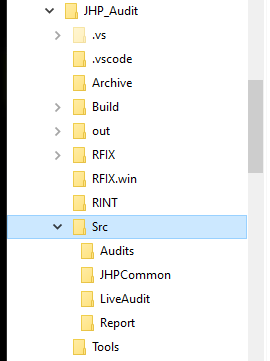

I have a project [JHP_Audit] with a folder structure like this:
My CMakeLists.txt file is in the ..\JHP_Audit\ folder and is here:

The main file is JHP_Audit.cpp and in the ..\JHP_Audit\Src\ folder.
I have other *.cpp and *.h files in:
..\JHP_Audit\Src\Audits\
..\JHP_Audit\Src\JHPCommon\
..\JHP_Audit\Src\LiveAudit\
..\JHP_Audit\Src\Report\

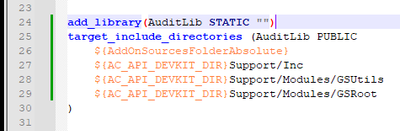

I have made some progress at this add-on project with source code in various subdirectories and getting my CMakeLists.txt file set with the right commands.  I am currently at a roadblock that I cannot resolve.
..\JHP_Audit\CMakeLists.txt
[problem area - line 24]
[complete file]

add_library(AuditLib STATIC "")
target_include_directories (AuditLib PUBLIC
	${AddOnSourcesFolderAbsolute}
	${AC_API_DEVKIT_DIR}Support/Inc
	${AC_API_DEVKIT_DIR}Support/Modules/GSUtils
	${AC_API_DEVKIT_DIR}Support/Modules/GSRoot
set (AddOnFolder .)
SetGlobalCompilerDefinitions ()
GenerateAddOnProject (${ACVersion} ${AC_API_DEVKIT_DIR} ${AC_ADDON_NAME} ${AddOnFolder} ${AC_ADDON_LANGUAGE})
set_target_properties(${AC_ADDON_NAME} PROPERTIES LINKER_LANGUAGE CXX)

The error message when saving the CMakeLists.txt edits:
[with the logical target names different - AuditLib and AuditLib_Src]
1> [CMake] CMake Error at G:\dev\v27\JHP_Audit\CMakeLists.txt:24 (add_library):
1> [CMake]   No SOURCES given to target: AuditLib
1> [CMake]
1> [CMake]
1> [CMake] CMake Generate step failed.  Build files cannot be regenerated correctly.
I believe this is because line 24 in the root CMakeLists file uses AuditLib as the logical name for the target and line 13 in the subfolder CMakeLists file uses AutoLib_Src as the logical name for the target.
[with the logical target names the same - AuditLib and AuditLib]
1> [CMake]   add_library cannot create target "AuditLib" because another target with the
1> [CMake]   same name already exists.  The existing target is an executable created in
1> [CMake]   source directory "G:/dev/v27/JHP_Audit/Src".  See documentation for policy
1> [CMake]   CMP0002 for more details.
This is because line 24 in the root CMakeLists file uses AuditLib as the logical name for the target and line 13 in the subfolder CMakeLists file uses AutoLib as the logical name for the target.
It appears the neither one of the options is correct.
