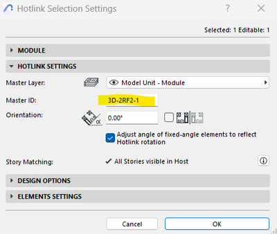

I am trying to create/place hotlink module via API.
However, I cannot find where can I set or get the Hotlink Master Id in either API_HotlinkNode or API_Element data.
I found this old thread:
https://community.graphisoft.com/t5/Archicad-C-API/Edit-Hotlink-Master-ID/td-p/366791

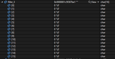

However, upon debugging, API_Element filler_3 doesn't have any data even though I specified a Master Id in my test hotlink module (I manually placed a hotlink module, specify the Master Id and read the hotlink element and hotlink node via API)

Akos Somorjai
That ID was moved to its more natural place in the element memo, under `elemInfoString`. Please use that field to get and set the ID.
Best, Akos
