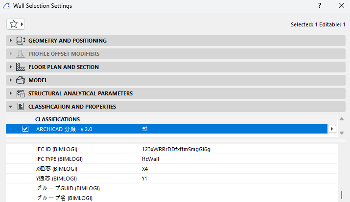

First of all, when viewed in ArchiCAD 28, the IFC property values are generated correctly.
The property set name is 'BIMLOGI', which is the property I created in the add-in.
This property is created correctly in both debug and release modes.
However, there is a problem when saving this as an IFC file.
If I create an IFC property in Debug mode and save it, the value exists when I open the IFC.
If I create an IFC property in Release mode and save it, the value doesn't exist when I open the IFC.
I can't even find the property set name 'BIMLOGI'.

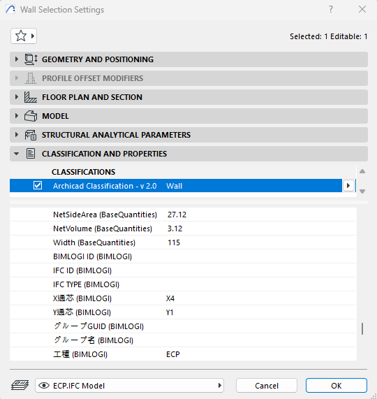

This image shows the property values when I open an IFC file saved in Debug mode.
The values may be different from the picture above, but these are the correct Property values for the object selected for capture.
This image shows the property values when I open an IFC file saved in Release mode.
The original .pln file contains property values, but I can't even find the property set name 'BIMLOGI'.
If I manually edit the values in "Manage IFC Properties...", there will be no issues when saving as an IFC file, even in Release mode.

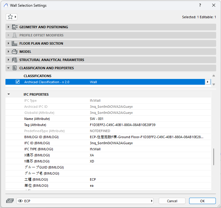

This is property window before save as .ifc file.
This is ifc property in ifc viewer.

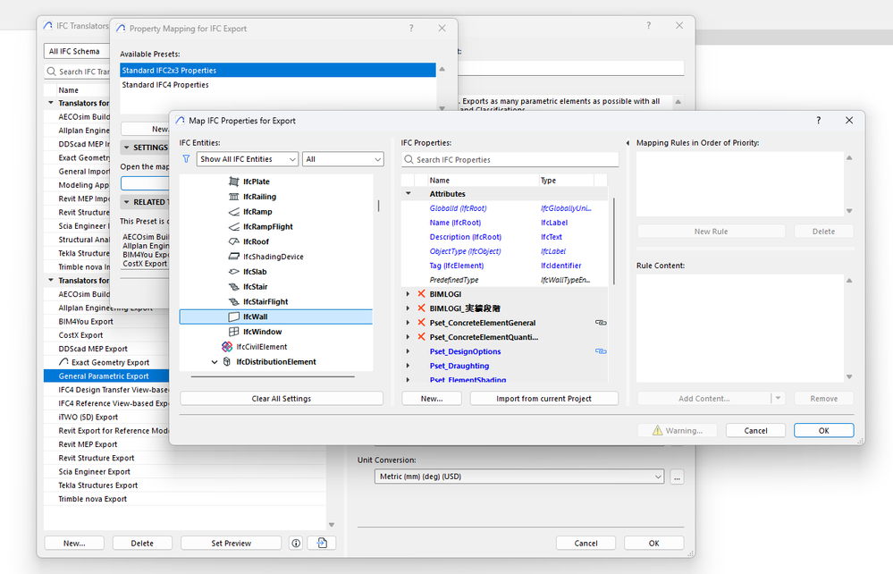

Hello.
I tried changing the IFC Translator, but the same issue persists.
There's a feature called Property Mapping, so I tried that, but it didn't resolve the issue.
I've attached a photo.
I created the ifc property using CreateIFCProperty and then modified it using ChangeIFCProperty.
Could you please test it?
