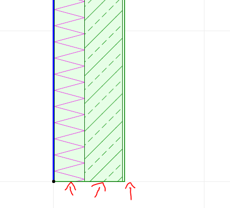

I want to extract the materials of a wall I have currently selected
I only know that I get the selected elements with this code (i guess)
GS::Array<API_Neig> walls;
GSErrCode err = ACAPI_Selection_Get(nullptr, &walls, false, true, API_InsidePartially);
2 REPLIES 2
