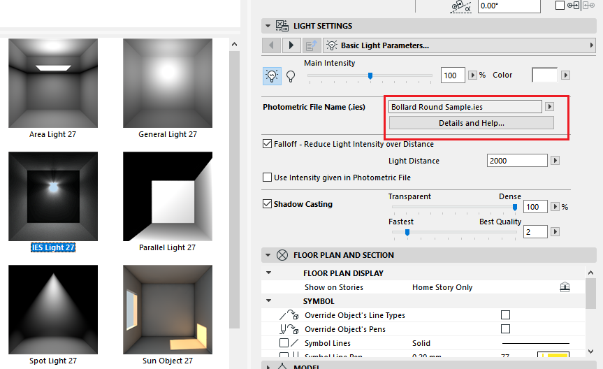

How can I obtain the complete path of the ies lighting file of Archicad?
I want to obtain the complete path of the.ies file of the ies light. How can I get it through the C++api?
2 Replies 2
Ricardo Lopez
Hi @WalterWhite

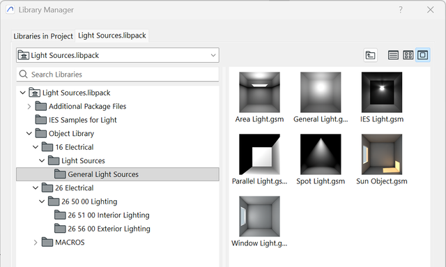

In Archicad 28 the .ies files were in the following filepath: C:\Program Files\Graphisoft\Archicad 28\Archicad Library 28\IES Samples for Light 27 and also as a libpack: C:\Program Files\Graphisoft\Archicad 28\Archicad Library Packages\Light Sources.libpack
In Archicad 29 they are also in a libpack: Light Sources.libpack> Object Library> Light Sources> General Light Sources
C:\Program Files\Graphisoft\Archicad 29\Archicad Library Packages\Light Sources.libpack
If what you need ia a new .ies file it can be loaded to the embedded library as a new object with Library Manager tool.
