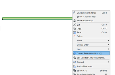

In Archicad, when we select an object like Wall / Custom object there is an option "Convert Selection to Morph(s)". Is there any way we can achieve this using API_DevKit?

As far as I know, that feature doesn't exist in API.
However, you can create morphs through geometry.
Check API_ElemInfo3D and API_Component3D.
Then, you can create body data using ACAPI_Body_Create.
