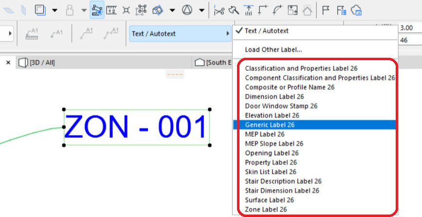

Hello everyone,
I am working with labels (tags) in ArchiCAD API. Now I want to get all the type of label (tag) level like the below image.
Do you know how to do that?
I am very grateful for your answer.
2023-10-19 07:41 AM
When you say "tag" you mean "label" (I have edited your post).
But what do you mean by "level"?
The name of the label?
The position of the label?

@Linh wrote:
@Barry Kelly I want to get all the label names in the attached image list. Can you help me
Sorry, I can't help you as I know next to nothing about API.
I just wanted to clarify what you (or tranthanhlo - same person different log-in?) wanted.

Hi @Tran Thanh Lo,
I haven't used it before, but I think this is possible with ACAPI_LibraryPart_PatternSearch().
First I would try to find the symbol label subtype and use that as an ancestor.

2023-10-22 01:39 PM
I did as you said but it still doesn't work. Can you look at my code below and give me advice?
Thanks in advance
API_LibPart libPart;
libPart.typeID = APILib_LabelID;
Int32 numFound;
API_LibPart result[50];
ACAPI_LibPart_PatternSearch(&libPart, "", result, &numFound);
2023-10-24 10:52 PM
Yeah I tried it now and it doesn't quite work like that. Unfortunately, the second parameter cannot be an empty string and I haven't found a string yet which matches everything. But a string with a space works to at least catch all labels containing a space 😅
API_LibPart libPart{};
Int32 numFound;
ACAPI_LibPart_PatternSearch (&libPart, " ", result, &numFound);
