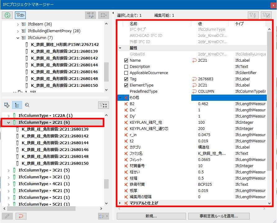

How to get "IfcColumnType" property with C++ API?
I can get the "IfcColumn" property, but I cannot get the "IfcColumnType" property.
"IfcColumn" properties can be obtained using "ACAPI_Element_GetIFCProperties(element.header.guid, false, &lstPset)".

"ACAPI_Element_GetIFCType" is different.
The "IfcColumnType" property is required.
This is the property in the red frame in the attached image.
Note)The "IfcColumn" property can be obtained using "ACAPI_Element_GetIFCProperties".
