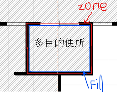

Hello everyone,
I'm trying to create Fills based on zone points.
Everything is okay with the code below when I get the zone points and create Fill according to those points:

But when the zone's calculated area is different from zone's Measured Area (like the image below), then the shapes of Fill and Zone are no longer the same.
The border of the Zone is a red line between the walls (like the image below), but when creating a Fill based on the points of the zone, the border of the Fill is a blue line and lies inside the walls.
Do you know where I'm wrong? And can you help me solve this problem?

Akos Somorjai
Please look at the `additionalPolyCoords` member of the element memo.
Best, Akos

Akos Somorjai
Please take a look at the Do_DumpZone() function in Element_Snippets.cpp (Element_Test example). The ACAPI_Database(APIDb_RoomReductionsID, …) code shows that at the end of that function.
