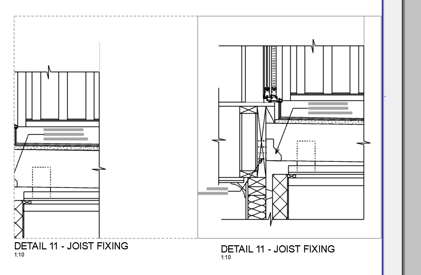

I am creating new drawings on a layout based on an old drawing on a layout, but with a different navigator item.
(in the example i just linked it to a different view map item of the same detail to see what isn't/is copied)
newElement.header.typeID = API_DrawingID;
newElement = oldElement;
newElement.drawing.drawingGuid = newNavItem.guid;
API_ElementMemo memo;
BNZeroMemory(&memo, sizeof(API_ElementMemo));
err = ACAPI_Element_GetMemo(oldGuid, &memo, APIMemoMask_DrawingData);
err = ACAPI_Element_Create(&newElement, &memo);
ACAPI_DisposeElemMemoHdls(&memo);
the neig items/equivalent sub-element of the new drawing are different from the old drawing.

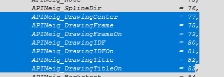

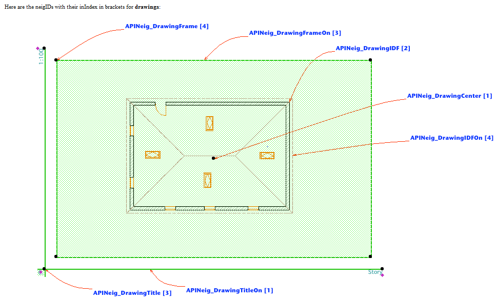

(P.S. the neig  definition images are missing from the online documentation for Archicad 28, so no-one can tell what they refer to unless you have old copies of the developer documentation)
Missing images
How do i copy Nieg settings or equivalent sub-element from one drawing and apply them to another drawing
The ElementHead_To_Neig only sets the NeigID to APINeig_DrawingCenter
How do i access/change/update  the APINeig_DrawingTitle[3] field or the equivalent sub-element setting for the position of the drawing title?
The only example i have been able to find that even mentions the neig, but doesn't try to change any of the sub-element related to the neig equivalent sub-element.
Is this just not possible to move the drawing title, or even get the drawing title location from another drawing?
