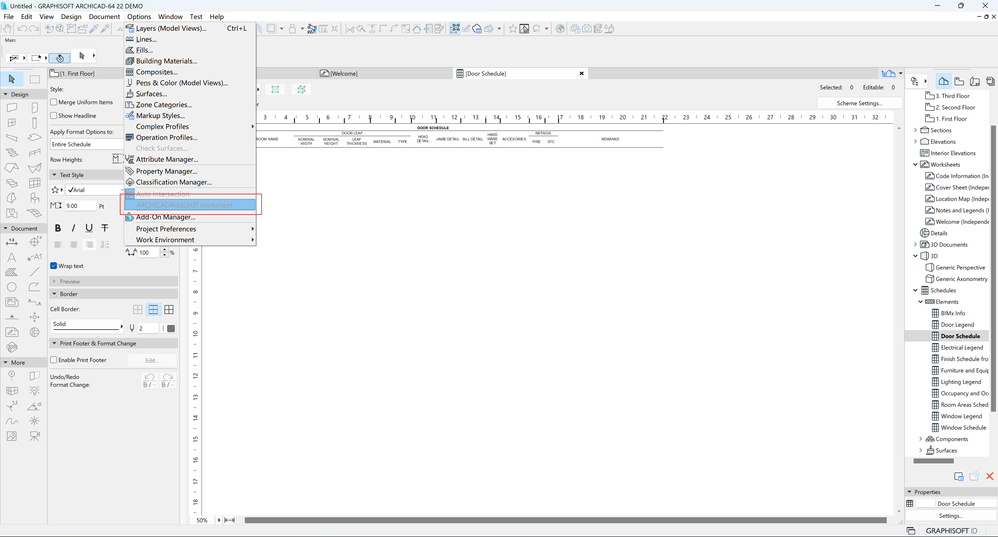

I hope my AddOn can be used in the schedule interface, it is gray now. 😞
I have tried these methods, without success.
Is there any other way?

Hi Luna,
I think there's actually no way to enable a menu command when you are in the schedule window. It's probably related to the issue, that we can't access schedules via the API anyway.

Thank you, Bernd.
Is there any way to export the schedule I designed into Excel? Of course, through my AddOn, not the AC's built-in save function.
You could setup the schedule to be published in a publisher set (not sure if this can be done via the Add-On) and then save it with ACAPI_ProjectOperation_Publish.
