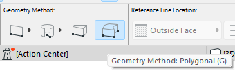

I would like to know how to create a wall using Wall Geometry.
What sample code can I study?
Solved! Go to Solution.

I work on old buildings a lot where wall thicknesses vary and often are not even parallel. You can either draw the polygon directly or trace over a survey drawing using the space bar click.
2023-10-09 02:01 AM - edited 2023-10-09 02:42 AM
thank you.
This is the c++ api forum. ^^
I found Polygon in API_WallType. I think I'll probably use this.
I don't know if it's true.
It hasn't been tested yet.
