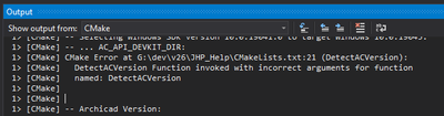

I am having trouble generating the build, in spite of settings I have made.  The error I receive while detecting the ArchiCAD version is:
The function used, from CMakeCommon.cmake, is:

So I backed up one step, and made sure I was getting a good value from AC_API_DEVKIT_DIR.  I am testing the value with a message before trying to use it.
message( STATUS "... AC_API_DEVKIT_DIR: $ENV{AC_API_DEVKIT_DIR}")
DetectACVersion (${AC_API_DEVKIT_DIR} ACVersion)
message (STATUS "Archicad Version: ${ACVersion}")
And, as the screenshot above shows, I have an empty string - no value.

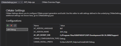

I am attempting to set this value in CMakeSettings.json:
and still get the error.

Hi Chris,
TLDR: Please try your CMakeSettings.json approach again and use "Project -> Delete Cache and Regenerate".  If that's not helping, I'm trying to give some explanations below why I think certain steps didn't work and some suggestions.
Longer explanation
I think there are several different causes for the errors in the different steps you are trying. I'll try my best guesses from the descriptions you were giving.
First of all we have to differentiate the environment variable AC_API_DEVKIT_DIR and the CMake variable with the same name!
Presumably you have something like the following line in your main CMakeLists.txt file:
set (AC_API_DEVKIT_DIR $ENV{AC_API_DEVKIT_DIR} CACHE PATH "API DevKit directory.")
This is the line were the CMake variable is set to the same value as the environment variable.
Now when you don't do anything special and generate the CMake configuration from within Visual Studio, the environment variable will be empty and thus the CMake variable as well. This is my best guess to what happened and you've then discovered.
Now your first try was to set it in CMakeSettings.json. This is actually a good way in my opinion.
There might be a few reasons why it still failed. I think most likely is, that the empty string value was still cached for the CMake variable AC_API_DEVKIT_DIR.
Be sure to use "Project -> Delete Cache and Regenerate". If that's not resolving the issue, i would recommend manually deleting the build folder and trying again.

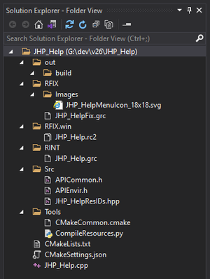

But I am not getting an .apx file.  I suspect I need to rearrange my file/folder structure, most notably putting the .cpp file in the .\Src folder.
I'm still digging around with this.  Thanks for sharing the knowledge so far...
- chris
EDIT:  Hurray!

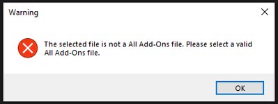

But firing up AC26 gets me this:
And selecting the .apx file to manually add it gets me this:
So close.
Will it ever end... !!!

MudratDetector
That did not take too long.
And, it even works!
Turns out the catch was an ERROR in defining CMAKE_CONFIGURATION_TYPES twice.  Not exactly which one of these fixed it but:
