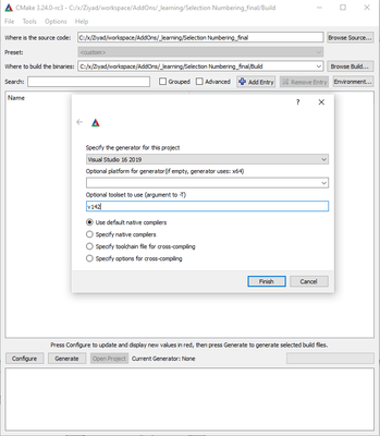

Dear Community,
I managed to build my first AddOn and it works perfectly on my machine, but when i try it on another i always get the error "Diese Datei ist ein veraltetes Add-On, dass mit dieser Archicad Version nicht verwendet werden kann." (Deepl Translation: "This file is an obsolete add-on that cannot be used with this Archicad version.").
So I found
https://community.Graphisoft.com/t5/Developer-forum/Using-the-Development-Kit-with-Visual-Studio-202...
where a similiar problem is explained. I installed the previous MSVC v142 as explained in the post and added the parameter to my CMake Project
But even after just building the Example AddOn i got the same error on other machines.
I tried it through command prompt instead of using the CMake GUI
But I'm still getting the error on other machines.

Well, i found my problem. It was actually the first point of https://archicadapi.Graphisoft.com/faq , I always published a debug version and not a release version. So i changed the settings in VS to Build and it works!
But I'm still curious about the manifest file, still havn't found it
