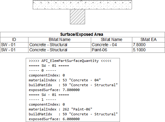

Here is a sample of a column "touching" a wall and the results of Scheme Settings and ACAPI_Element_GetSurfaceQuantities().
EDIT
BTW, this function is working fine if the elements intersect each other.
~ReignBough~
ARCHICAD 27 INT (since AC18)
Windows 11 Pro, AMD Ryzen 7, 3.20GHz, 32.0GB RAM, 64-bit OS

Here's another problem on "Exposed Area" using API.
~ReignBough~
