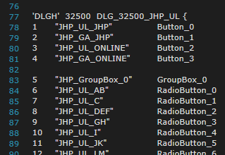

My goal is to gray out or disable the ability to select a radio button at runtime.  For example, all of these are non-grayed and selectable:
I suspect this is a TRUE/FALSE  or a .IsEnabled/.IsDisabled setting for the individual button based on the control ID and I am already able to determine which ones get which setting.  I am also guessing I can loop through the controls collection and apply the predetermined setting to each button as it comes up in the for loop.
What I am not sure of is how to acquire the controls collection and the type or use of the control ID.
Is the control ID the string ["JHP_UL_AB"] or the other reference [RadioButton_0] from the .grc file?
Is the control ID the non-string [UL_AB_Radio] or the other reference [UL_ABID] from the class definition?

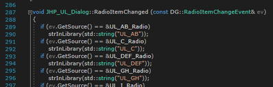

I suspect it is the non-string [UL_AB_Radio] since I am able to know which button is selected by using the non-string and provide the corresponding argument to a function that will determine the enable/disable state.
In testing, I am successfully scanning a list of strings that represents the control IDs for each individual radio button and verify the setting with text output to the Report window.

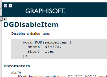

The point of my post was that DGDisableItem(32500, UL_DEFID); is the old C syntax which the API is moving away from. The one I posted is the new c++ implementation which you should prefer. Avoid mixing C and C++ any chance you get.

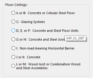

I think I have narrowed down what I am looking for.  If I hover over any of the Radio Buttons, a tool tip sort of identifier appears and I suspect that this is the Control ID I am looking for.
Or maybe not.  Chipping away at it over here boss...

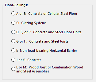

Hard coding this:
Results in this:
Now... to just loop through the Controls collection and be able to access and manipulate with the non-string identifier.

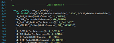

Thanks for the reply Julien.
I am currently accomplishing this button availability exercise in my constructor.  The code below disables all buttons without the logic in place to determine which ones get the ax.  This configuration is only proof of concept for me.
JHP_UL_Dialog::JHP_UL_Dialog() :
	DG::ModalDialog(ACAPI_GetOwnResModule(), 32500, ACAPI_GetOwnResModule()),
	UL_JHP_Button(GetReference(), UL_JHPID),
	GA_JHP_Button(GetReference(), GA_JHPID),
	UL_ONLINE_Button(GetReference(), UL_ONLINEID),
	GA_ONLINE_Button(GetReference(), GA_ONLINEID),
	UL_BOX_0(GetReference(), UL_BOX_0ID),
	UL_AB_Radio(GetReference(), UL_ABID),
	UL_C_Radio(GetReference(), UL_CID),
	//more of the same
	OK_Button(GetReference(), OkID),
	Cancel_Button(GetReference(), CancelID),
	UL_LOGO_Icon(GetReference(), LOGOID),
	File_Button(GetReference(), FileID),
	Verify_Button(GetReference(), VerifyID)
	short arrRadBut[11] = { UL_ABID, UL_DEFID, UL_GHID, UL_IID, UL_JKID, UL_LMID, UL_NOID, UL_STID, UL_PQRID, UL_UVWID, UL_XYZID};
	for (int k=0;k<11;k++)
		DGDisableItem(32500, arrRadBut[k]);
	AttachToAllItems(*this);
Thank you for that explanation.  I am pretty new to this as well and don't know what I don't know.  But I did grab that approach using DGDisableItem from the AC API 24 documentation.
