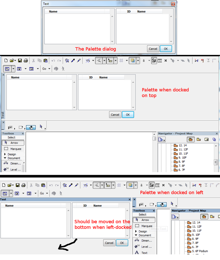

Hello,
Is there a DG Message in callback when a palette dialog is docked? Or know when docking location changes/what the docked location is?
What I want to do is to re-arrange my dialog items whenever the dialog is docked according to its docked location.
For ex. I have a palette with 2 list box: if I docked it on top, it will look like the 2nd screen. If I docked it on left/right, instead of the one in the 3rd screen it'll move the 2nd list box and put it at the bottom of the 1st list box, taking less space than if I didn't re-arrange it.
Is this possible?
