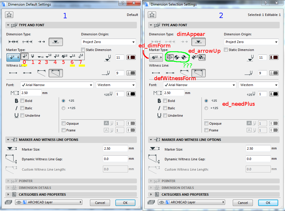

Hello again, I found some issues about Dimensions this time and it looks like its related to this so I'll just post it here.
This is when creating Elevation Dimensions (dimension.dimAppear = APIApp_Elev 😞
1. OnACAPI_Element_Create , dimension.ed_dimForm accepts values 1-5 but not 0, 6, 7 (see left image for reference). If those values are passed it reverts back to symbol 1.
2. Whendimension.ed_dimForm = 5 , I've tried looking up which of API_DimensionType variables corresponds to the settings dialog (see right image for ref) and I can't figure out which one affects the "Level Dimension Marker Style" (green circled on the image). If I pick the 1st one then displayed the struct's values, it's the same values when I then pick the 2nd or 3rd style.
On creation though it doesn't revert to a default value, it uses whatever the chosen style on the default settings dialog, even ifed_dimForm = 5 is not currently the default.
Any help on this?
Thanks for the help.

Erenford wrote:Hi Erenford,
This is when creating Elevation Dimensions (dimension.dimAppear = APIApp_Elev😞
1. OnACAPI_Element_Create, dimension.ed_dimFormaccepts values 1-5 but not 0, 6, 7 (see left image for reference). If those values are passed it reverts back to symbol 1.
2. Whendimension.ed_dimForm = 5, I've tried looking up which of API_DimensionTypevariables corresponds to the settings dialog (see right image for ref) and I can't figure out which one affects the "Level Dimension Marker Style" (green circled on the image). If I pick the 1st one then displayed the struct's values, it's the same values when I then pick the 2nd or 3rd style.
On creation though it doesn't revert to a default value, it uses whatever the chosen style on the default settings dialog, even ifed_dimForm = 5is not currently the default.
Any help on this?
The first issue has been fixed in AC20 build 5518, so any update with a higher build number contains the fix.
The second issue is another a bug, thanks for pointing out!
Best, Akos
