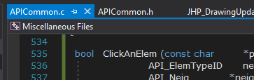

The error means that the compiler found the function definition, but the linker wasn't able to find the compiled version (object file) of that function. Probably it was never compiled. Make sure to add "APICommon.c" (the c file, not the h) to your project. In Visual Studio you can right click on the project, and then select Add/Existing item.

I have added APICommon.c to the project in Visual Studio.
After saving the project and hitting F7 to build, I was getting [error C3861: identifier not found] errors.  I solved this by copy/paste-ing the referenced functions from 'APICommon.c' into and above the call to those functions in my 'projectname.cpp' and commenting these out of the 'APICommon.c' file.  My menu item now builds without error and executes as expected.
However, I have to believe that my cut/paste/comment solution is not the path of least resistance.  Knowing that the placement/location of the function definition relative to the function call matters, is there a better way to accomplish this without having to resort to my cut/paste/comment solution?
