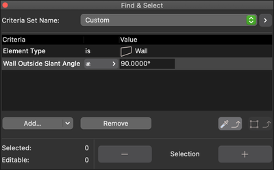

You do know you can use Find & Select for this?

Honestly no, I didnt. But I'm not an architect, just a developer 😄
But I think that tool wouldn't suffice. We also want to check for all multiples of 90° or 45° and also have the option to enter a project offset. While you could manually put in all those values, it would be easier to solve this problem with an addon.
