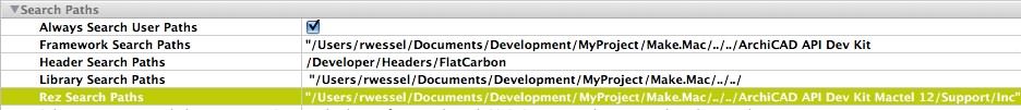

nikko wrote:"ResTmpl.r" is an include file bundled with the ArchiCAD API, and is required for compiling an add-on's resources. It can be found in the Support/Inc directory of your API dev kit. Jut add a path to this directory to the list of Rez Search Paths (see attached image)

Thanks very much Ralph,
It turned out that my installation of Xcode 3.1 was the problem.
I reinstalled Xcode 3.1 without the iPhone SDK and everything is working as expected. (Code compiles)
