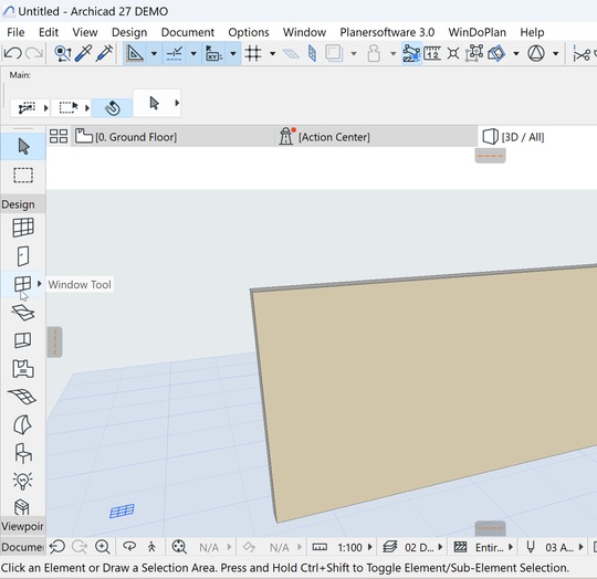

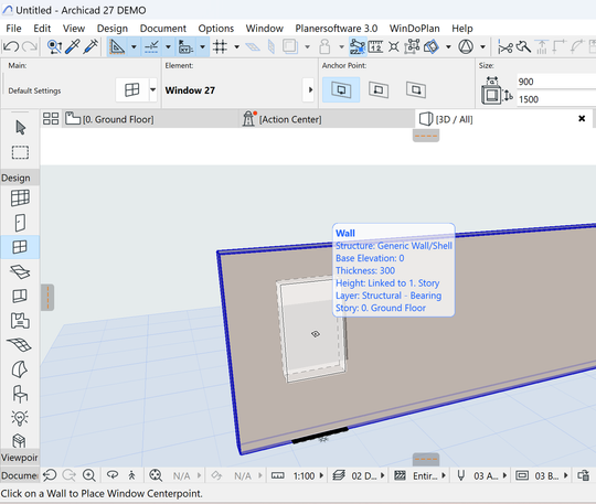

If the user clicks the Window Tool, then a preview of the last selected library part is shown and the element can be inserted with a click. How can I check via the API by code, if this preview is actually shown or if the mouse arrow is shown?

Hi, You can monitor whether user switches to Window Tool by using ACAPI_Notification_CatchToolChange() command
and also, get the last selected window settings by ACAPI_Element_GetDefaults(), but I'm afraid you're not able to monitor the operation whether user moves the mouse on wall or not.
