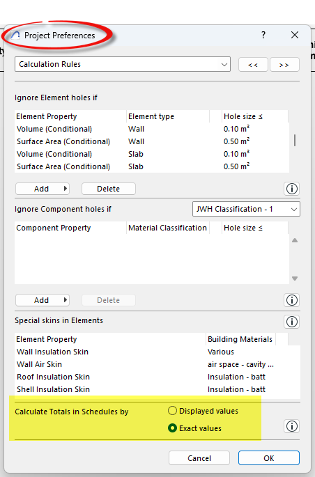

I Would like to point a problem that Archicad has for decades - the Sum of Areas in an interactive schedule differs from the Sum the archicad built in system or your script gives us.
Thats clearly a rounding error but for some of our customers it's crucial that the sums are exactly the same. The error is in the 2 digit after the comma.
Are you aware of this and do you see a way to compensate or even solve this issue?

I have not studied the script, so I can't say how the totals are calculated there.
But in the schedules you do have an option.
Actually the setting is found in Project Preferences > Calculation Rules
It can total the exact figures you see in the schedule, or the real un-rounded figures that you don't see.
pr3
Barry this is it - thank you so much.
