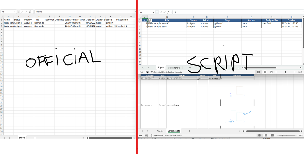

The exercise I attempted was to correct the export of issues from Archicad to Excel. The official version only exports a list without comments and, more importantly, without screenshots, which makes this type of export useless for us.
However, the official BCF export includes these elements.
By combining two scripts:
  • Archicad to BCF (Tapir)
  • BCF to Excel
I created a script that directly exports issues in XLS format, including screenshots and comments.
100% vibe coding, I did not personally code this script.
