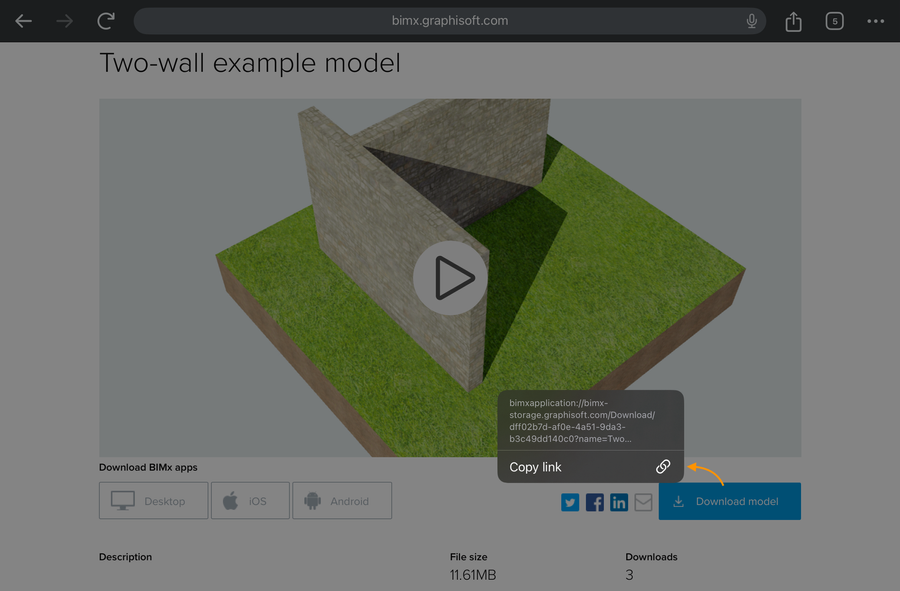

Use the below-described model import URL instead of sharing a model's BIMx Model Transfer website URL (e.g. this simple link), ask your client to open it, and import the model to the app with BIMx Model Transfer's Download button.
The easier way is to copy the model import URL with a long tap on BIMx Model Transfer's Download button on a mobile device, e.g. Chrome on iPad:
Copied URL:

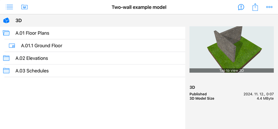

Same URL inserted: Import to BIMx Mobile.
Tapping the URL immediately starts importing the model to BIMx:

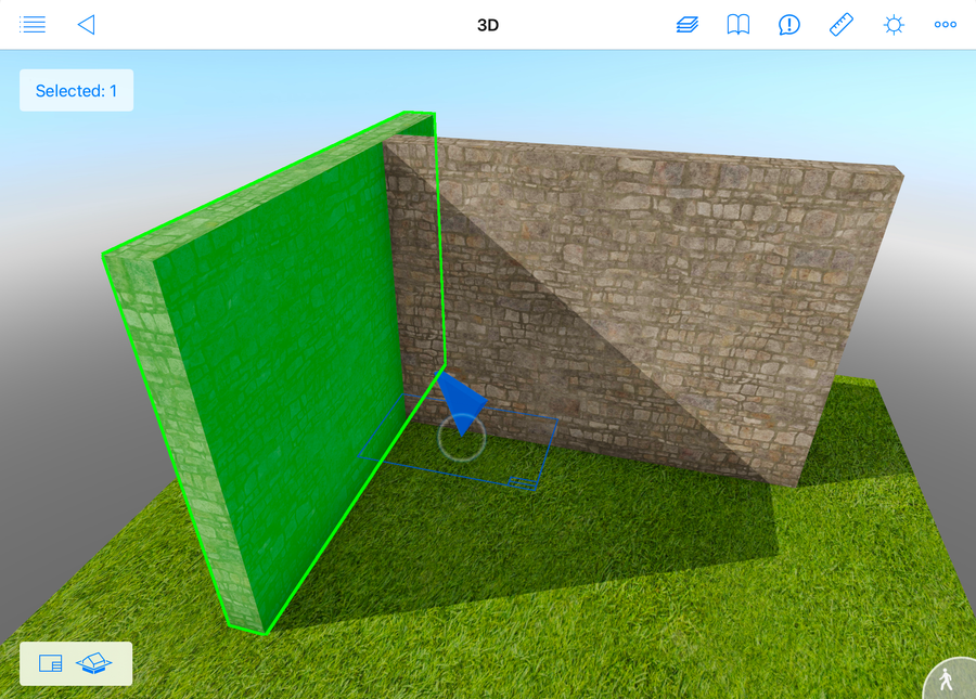

You can create hyperlinks directly to 3D elements. This allows you to simplify getting into context. No need to search the Hyper-model in BIMx, open a 3D model, and navigate to the proper camera position.
Same link inserted: Open wall element in BIMx. Result:
The copied hyperlinks work the same way on iOS, iPadOS and Android.

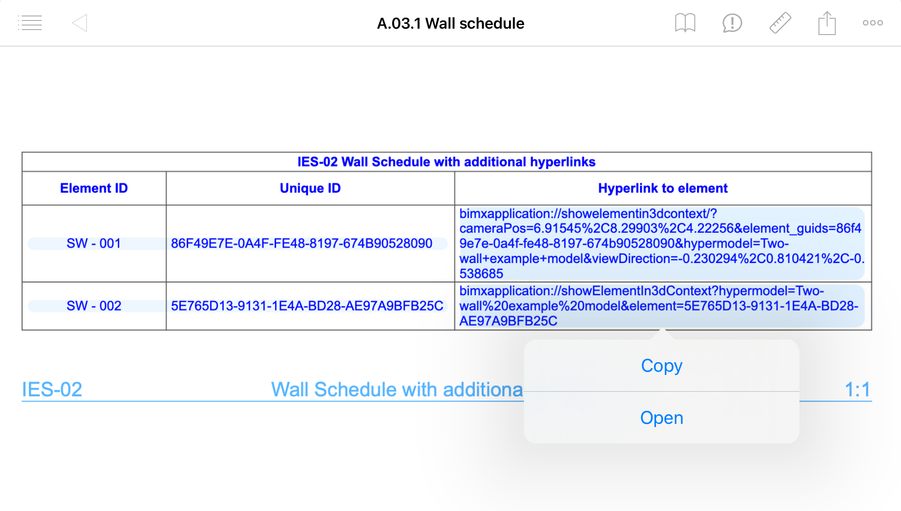

The third part contains the Unique_ID of the element(s) that you want to access with the hyperlink. The hyperlink can contain multiple Unique_IDs, so BIMx will open the 3D model with all listed elements, selected in green color.These IDs can be obtained in Archicad by listing the Unique ID field in an Interactive Element Schedule:
In addition to this automatic hyperlink between 2D and 3D, you can add any BIMx hyperlinks to schedules as custom texts. E.g., element hyperlink with camera position (copied from BIMx) or without it (created manually):
