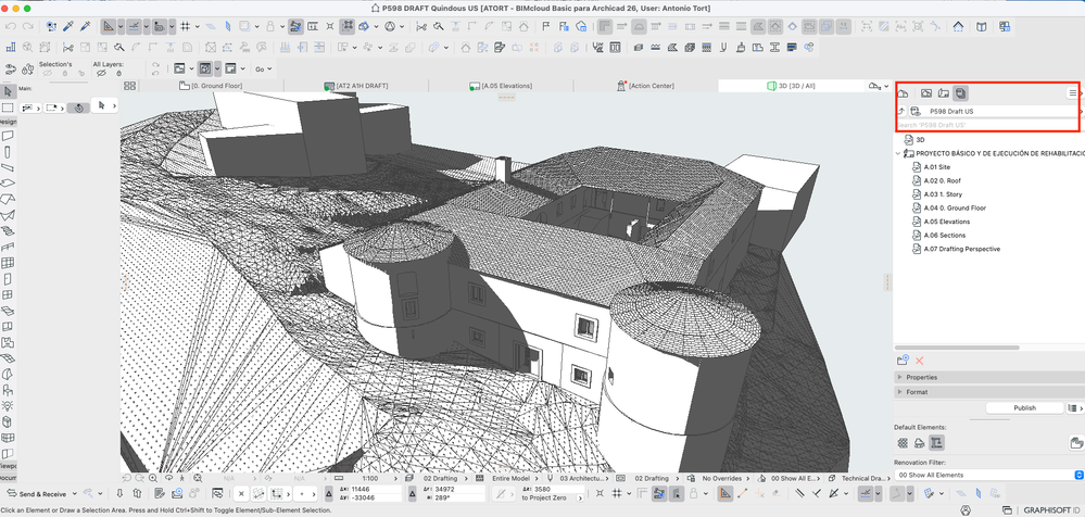

In case it might be useful to anyone, I finally solved the problem by generating the BIMx file from the "file" drop-down menu, instead of doing it from the publisher.
A26 ESP · Mac Studio M1 Max 32Gb Ventura 13.2.1 · iMac 27" Late 2012 2,9Ghz i5 32Gb GTX660 Ventura 13.2.1 (Yes it runs on it)
Roland Szabo
Hi, I'm glad to hear you could export the model properly. It seems the content of 3D View in the Publisher differs from what the Wizard saved.
We want to correct the misleading dialog in BIMx or handle this issue in the export. Therefore, please send the project in .pla format to bimx@graphisoft.com. (Your previous mail arrived, but the linked Hyper-model is no longer available on BIMx Model Transfer.) Thanks!
