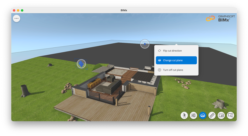

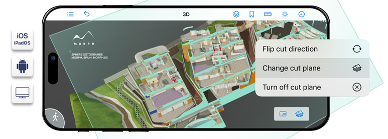

Then, open the cut plane context menu with long tap on mobile or right/long click on desktop:
RolandSzabo_3-1747791190878.pngWhen viewing the model from above or in front of the cut plane, only the edge of the plane can be interacted with. This provides proper 3D navigation and access to features within the cut model, such as element information, measure, etc. Moving below or behind the cut plane automatically makes its entire area interactive, indicated by a semi-transparent color fill.

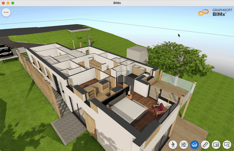

The Change cut plane function opens the dynamic cut plane indicator. Move your cursor on desktop or the pointer on mobile to find which element surface to cut parallel with. Yellow indicator: horizontal or vertical surface. Purple: slanted.
To update cut position, simply click or tap.
To close the cut plane indicator, press Esc on desktop, or single tap anywhere on mobile.
