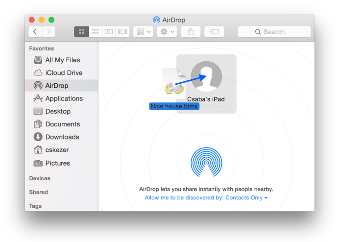

Send via AirDrop
AirDrop is a simple option for moving files between nearby Apple devices wirelessly. It works with BIMx files just like with any other: find the nearby device and simply drag and drop the BIMx file in Finder to the iOS device where you would like to send it:
Once the file is sent, a message appears on the iPhone/iPad that downloads the file and imports it into the BIMx application automatically.
NOTE:: This option works best with smaller BIMx files, transfer speed and reliability may decrease with larger BIMx Hyper-models.

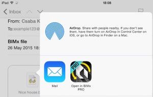

Sending as an email attachment
You can send models as a simple mail attachment, but note that even a small size model can take up more than 10 Megabytes. Not many email providers support such large attachments, so you have to make sure that the recipient's mailbox is capable of handling the attached model's size. (e.g. Gmail supports attachments up to 25 Megabytes in size.)
  • attach your model to an email message
  • open the mail on the iOS device
  • tap on the attachment
  • after it is downloaded you will be able to open it in BIMx
