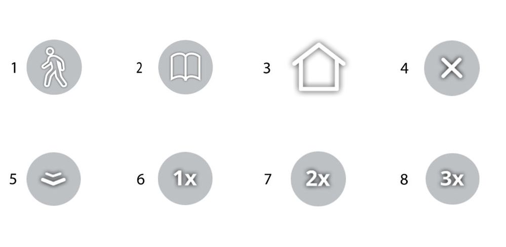

Interface Elements
The VR mode proposes several icons which will help you navigating through your building in a smooth way.
  1. Walking mode
  2. Bookmarks (Favorites + Gallery)
  3. Home
  4. Exit
  5. Step back
  6. Slow walk
  7. Fast walk
  8. Very fast walk
