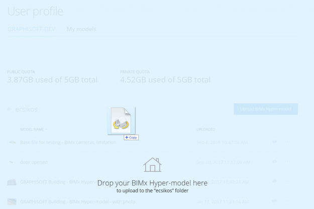

You can select the file to be uploaded by browsing in the file open dialog or you can simply drag and drop it to the target folder.

  • either hit Open or simply drag and drop the file

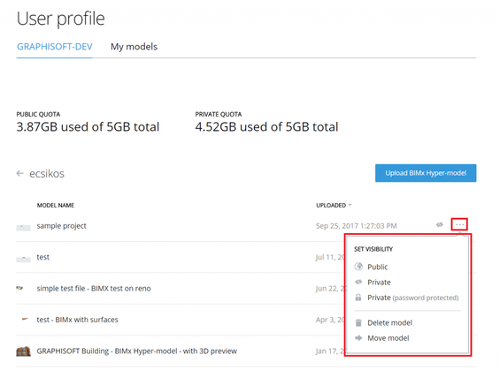

You can also change the visibility of the hyper-model after uploading it to the site.
