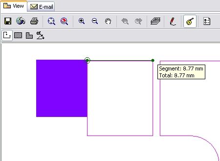

Just started using AC10 on actual jobs in the last few days, and have found a problem. When I publish DWFs and then view them on the project reviewer, the measure tool doesn't seem to be giving accurate dimensions - for example, in the attached image, the thing I am measuring should be 400mm, but the project reviewer is telling me it's about 9mm. hmmm. I've tried exporting as ASCII, Binary and Compressed Binary, and same result...
... just went and tried it again, discovered that, when publishing a layout, rather than a view, the measure tool was giving me the 1:1 measurements, as if measuring from an piece of paper with the drawing on it. Tried publishing a view from the view sets, and the measure tool gave me the correct measurement.
(I seem to have typed 'measure' a lot.)
So, now my question has changed a bit - is there any way to publish from a Layout, and set the scale that the measure tool uses (so, for example, instead of measuring at 1:1, it measures at 1:50)??
