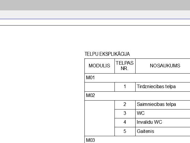

AC20 (on windows) does not recognize special baltic (latvian) characters as - ā, š, č, e.t.c. in placed schedules.
In the project map the text is fine, but when the schedule is placed on a layout, the special characters are not shown.
Has anybody encountered this problem?

2x28" (2560x1440), Windows 10 PRO ENG, Ac20-Ac27
Regional settings - non unicode language is set to Latvian
Capture1 - with hyphens on a and i
Capture2 - on layout the hyphens are missing

Found a solution!
https://helpcenter.graphisoft.com/troubleshooting/documenting/fontscharacters-troubleshooting-guide/
solution is the same as with russian font problem, you have to change the registry value for font script code to 186(baltic)
https://msdn.microsoft.com/en-us/library/windows/desktop/bb322881(v=vs.85).aspx (different font script codes for different languages)
Only problem is, that i have to use russian on some projects, so it just means changing the registry value back and forth all the time, and using both on the same project is not possible.
