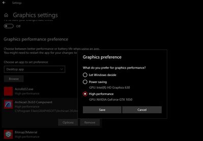

Dear community members,
I am writing to discuss an issue that I have been experiencing with ARCHICAD on my gaming laptop [https://www.lenovo.com/ca/en/d/gaming-laptops]. Specifically, I have found that the program crashes frequently, and I believe that this issue may be related to the dual graphics cards in my laptop.

I have tried updating my graphics drivers, adjusting the graphics settings in ARCHICAD, and even disabling one of my graphics cards, but these measures have not resolved the issue.

Hi Judy
Are you using windows? I use a gaming laptop & had the same problem, I fixed it & no longer get this problem, in Win 10 I went to settings, Display, Graphics settings, select Archicad, click options & select high performance as the default option this forces it to use your  NVIDIA or AMD
graphics, I do this for any CAD or graphics programs.
I hope it helps.

By dual I believe you mean integrated and dedicated.
I have only ever used gaming laptops. I never had crashes but I hate the auto switching of graphics so I actually had to use a program my laptop came with to turn off the integrated card so that my laptop only uses the dedicated card.
Windows 11 makes it hard to force ArchiCAD to use the dedicated graphics. Basically you can't control it with out a third party program that can disable the integrated card. At least that's been my experience when I was monitoring loads.
I have an msi laptop that comes with a program specifically for this. Not sure if the one you have has something similar.

Hi Yes
I do mean integrated and dedicated, I can also access which card  to use in the graphics driver mine is the NVIDIA driver, you just have to right click on the desktop & choose NVIDIA then when the panel opens you can access the settings for which graphics board to use with with each program  in my case NVIDIA, I set all graphics & CAD apps to use NVIDIA
Believe it or not the NVIDIA control panel gets overwritten by windows. I thought that worked too but when I  ran load tests my machine was still switch between cards while using ArchiCAD.  After some further reading and research I found that the only way is to completely disable the integrated card, but doing through the device manager will cause ArchiCAD not to run.
Maybe your machine is different but it's been the same on all three of my computers.
This is for windows 11 that it's an issue. Windows 10 still lets NVIDIA control the graphics
