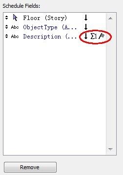

For the elements, the schedule are made for showing the quantity. However I could only showing the quantity of the item at the same column. (See Fig. 1 and Fig 2). Is there any solution for make the quantity at the column behind the item.

Not sure I understand what you mean by 'behind' in issue 1. If you mean that you would like the quantity in a new column, that is not possible
