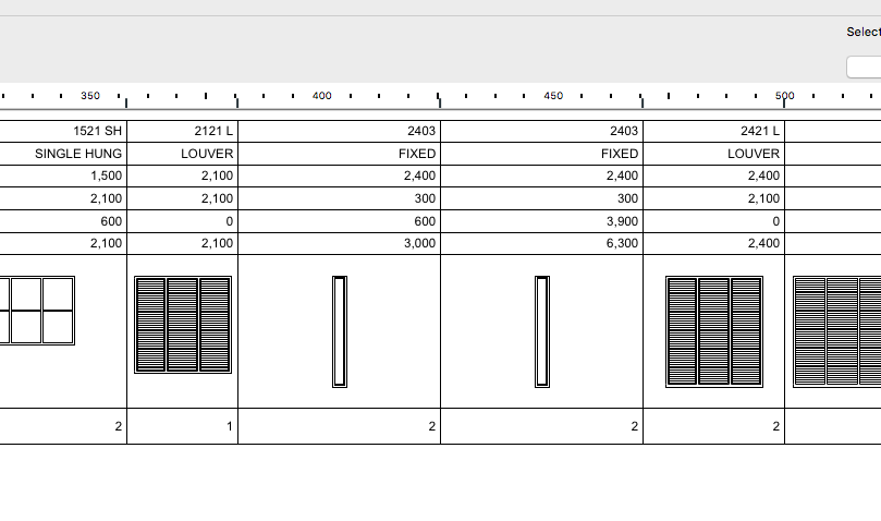

My window schedules looks fine except there are usually a couple of columns that won't adjust properly. I can drag them wider but not make them narrower, like other columns.
The preview doesn't take up the space nor does the wording or anything else. I can't understand why I am unable to reduce the width of these columns. I also try to double click on the line in the ruler but that does nothing.
Very frustrated and would appreciate any advice, thanks so much.

Hmm, this is working just fine for me, I can increase or decrease the width of Columns as I please. I can either click hover the cursor over the vertical cell border marker line on the ruler above the generated schedule, click and drag it to adjust its width.
Or I can simply double-click that vertical marker line and the width of the column will adjust to the smallest width so that the text and 2D/3D Views still fit.
Alternately, there is a ... button at the upper left corner of the schedule, where the vertical and horizontal rulers meet. Click it and it takes you to a Dialog where you can manually specify the width for Columns and height for Rows.
2x28" (2560x1440), Windows 10 PRO ENG, Ac20-Ac27
I have the same problem... column width can be dragged on, but the width doesn't change. Double-clicking also doesn't change the width. Can change ALL column width by clicking on the ... button.
