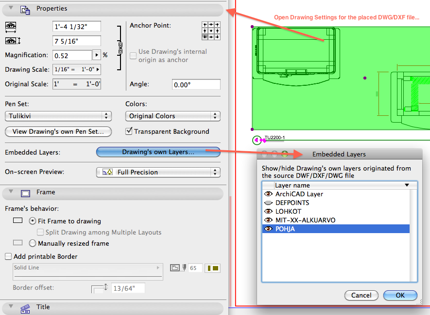

Forgive me if I missed this in skimming this thread...
But there is also a new feature in ArchiCAD 14 which lets you place external drawings and control the dwg/dxf layers via the new embedded layer feature.
You control layer visibility as shown via the Drawing Tool settings - the dwg/dxf layers never appear in the project Layers. If the source file uses layers in a way that works with what you want to present, this is a way of avoiding the old import/merge/modify workflow.
Cheers,
Karl
