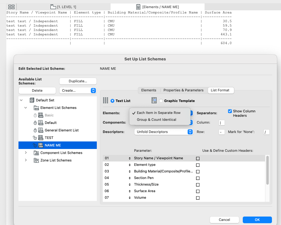

Thanks Barry,
I have never dipped into lists but always assumed they were a potential way to look under the bonnet of a file.
I'm getting some kind of BIMcloud library issue by the looks of things which is stopping me creating a new List Scheme, might have to do a bit more reading into how it's setup.
Anyway thanks for pointing me in that direction.

The lists were pre-BIMcloud.
The schemes need to be editable so I guess they can't be in the BIMcloud library.
They would need to be in an office library that all users have access to (as mine are - I don't use BIMcloud).
Any amendments made are made to those files in the office library, so all users get the changes with a library re-load.
They could be saved in the Embedded library, but they would only be good for that one file.
