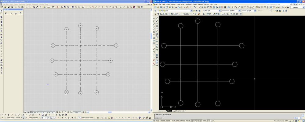

DWG Translator - Grid Tool Marker Text not translating
I'm having trouble with the grid marker symbol not translating the text into AutoCAD. As you can see in the attached image, the grids will appear but the marker has no ID in it. If I explode the grid marker (block) in AutoCAD, it will show the attribute ID for the grid marker.
In the translator under Save Options I have it set to Explode complex ArchiCAD Elements but it still translated into a block. In a previous project, we used the 2D grid marker object which translated just fine. I'd hate to abandon the interactive AC grid marker because our official file format for exchanging data is in .dwg and it's more time consuming if we have to manually input grid marker text in AutoCAD.
Is there a work-around? Am I missing something? Is this a bug or something that needs to be reported to GS to be fixed?
Thanks!

at my workplace i get grid marker symbol. But its not exploded in plan. It is some kind of intelegence object and if i double click on it it will be opened in enanched attribute editor in autocad
Here is a pic

What I meant was previously we were using with the Column Grid Indicat_NCS 13 from the objects library. This may be the first time we are attempting the AC13 grid object with hope it's not as "buggy" as the previous versions.
I never intended to explode it to begin with - I worked with default settings in both the grid tool and DWG Translator and that's the results shown in my attached image. I only exploded it after opening in AutoCAD and that is when the attributes appeared with incorrect tags. Point is - I know there are attributes but it is not translating properly for me.
I noticed in your signature that you are using AC12. Is that where your translator example came from? I am using AC13 so I now wonder if it was something that changed in the new version upgrade. EDIT - no, same thing happened to in version AC12. So, if it is working for you - I will have to comb through my translator settings and see what needs to be adjusted.

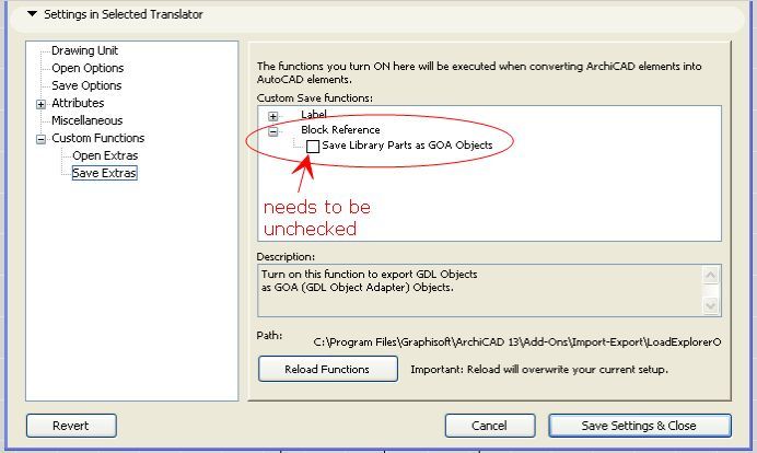

Problem solved! Found the setting that needed to be adjusted - see attached image:

Karl Ottenstein
Glad you solved it. I've always left that checkbox unchecked because I have no idea what a "GOA Object" is. My ignorance worked in my favor I guess. Can anyone enlighten me?
Thanks,
Karl

vistasp
I thought it had something to do with the beaches of sunny Goa... until I looked more carefully at the screenshot above.
"GDL Object Adaptor" object.
