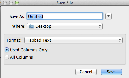

Hi all,
I am currently trying to find a way to export a component list as a CSV (or TXT) file with the correct formatting. I need the file to only include the Component Code and the Component Quantity columns however I can't seem to find a way to 'turn off' all of the other columns (some will turn off but others are always on). Also, when the schedule is created it includes extra spaces and pipe symbols | to make the schedule look pretty, but I don't want all of those.
I would like the file formatted like this...
Code1,Qty1
Code2,Qty2
Code3,Qty3
I have searched the forum with no luck, does anyone know if this is possible?
Thanks.

Fortunately, you don't really want a CSV file (since fields contain commas - which leads to problems unless the contents are included in quotes)... but a tab-delimited file.
Any app that can parse a CSV can also parse a tab-delimited file - e.g., any spreadsheet program, database, etc.

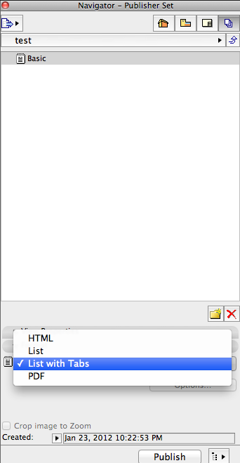

You can either save the displayed list properly, or set up a Publisher set to create the tab-dlimited files automatically for you as the model evolves.
If just saving, select "Tabbed Text" as the format. You probably want "Used Columns Only", also. See attached...
For your Publisher set, select List with Tabs as the format for each Component List that you drag into the set.

Publisher screenshot...
