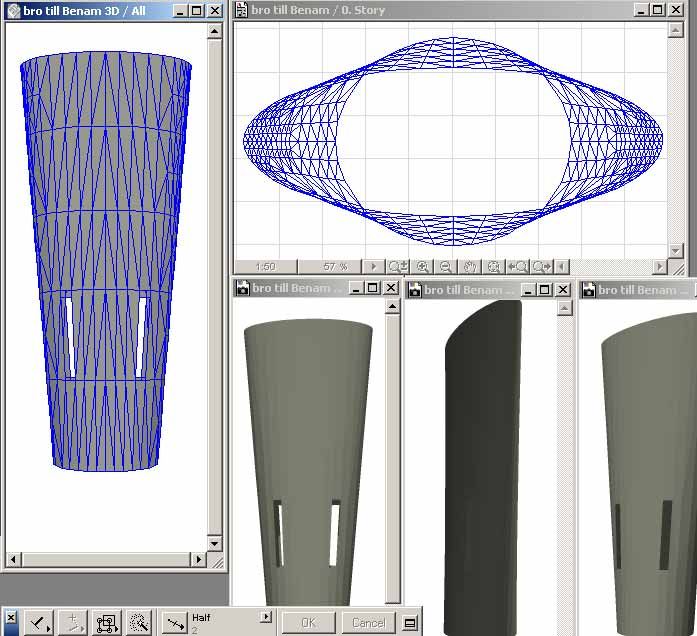

How to avoid this with 3D dwg import?
I saw the thread about .3ds and that could be the solution to my problem with importing 3D dwg objects. As shown in the attached image not all of the 3D surfaces from in my case Rhino gets converted to a mesh object (the holes in the column). I suspect this has to do with inflexion points. A mesh object cant have two z-coordinates in the same x,z.
I've downloaded the 3ds apx and will try that with AC8 but I wonder if there's any way to get a dwg to work the way I want!?

I tried the 3ds apx and it works fine with AC8. No more 3D-dwg...
