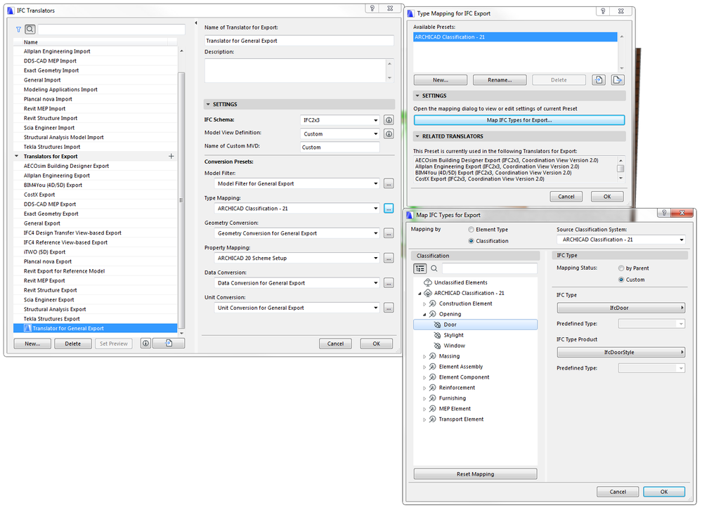

I'll post a series of screenshots:
Image two which shows the IFC Translator setup.
Image three which shows the IFC Import result in Solibri.
Thanks for posting those screenshots. In my "Map IFC Types for Export" the list of types in my file is much shorter. I have messed something up but I think I can get it back as I have found opening the ArchiCAD 21 Template file has the same settings as your screenshots
