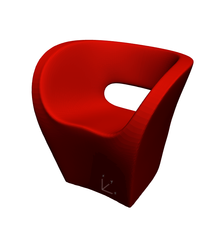

I'm trying to create library parts from revit files (.rfa)
Is there any chance to import .ifc and then create .gsm from it?
I tried to, but I only get a useless .gsm that I can't import in another AC project...
You can import an IFC, which then you can convert to Morph.
You can then change the Morph to your needs, including settings the Surfaces of its various faces and making edges visible/hidden, then you can save that as a GDL Object.
2x28" (2560x1440), Windows 10 PRO ENG, Ac20-Ac27
Thank You very much!!
Its working now.
I tested also exporting to dwg from Revit and I get a better result this way, and then converting to Morph....This Morph thing is just great.
Thank You again
