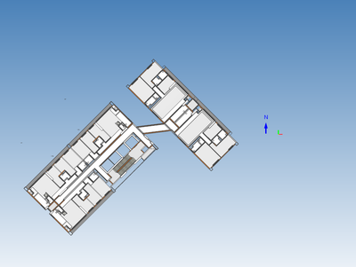

Here's an IFC we generated from our model using the Project Origin (disregarding the survey point tool)
Y axis (green) and X axis parallel to the construction itself. Geographic north (shown in blue) points to the corner. Those were also the guidelines we were following according to the BEP.

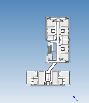

Due to a project fix workaround, we had to move the origin Z coordinate 0,86m downwards in an advanced stage of the design process. So we decided to use the Survey Point tool, placing it at the exact same point as the Project Origin, but adding the Z displacement. If we export using the survey point, this is what happens to the model orientation:
It obligates me to have the model Y axis facing the Geographic North.
So what we ended up doing is messing up our Geographic north to match our former Y axis, so we can keep the model coordinates orientation untouched. Many flaws in doing such, for instance, any solar anlysis we create will be invalid.
I wonder why there is such obligation to match North and Y when we're using the Survey Point. Here in Brazil very often the BEP's specify the model origin and orientation based in what will put out a more solid and precise model to go to the site, and using a random angle which is the geographic north as Y generates many difficulties in the process.
