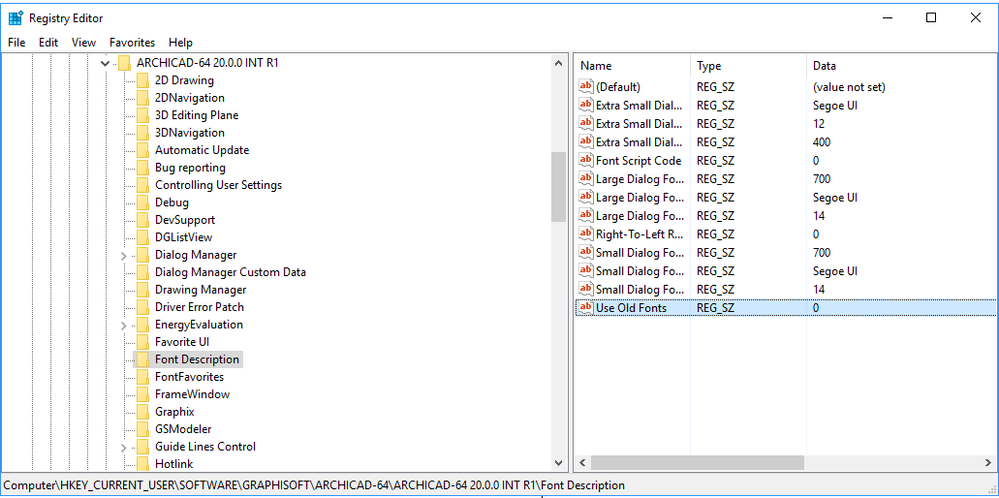

The question is: Is there a way to change the default listing font (like a registry key somewhere?) so that the old functionality would still be availble?

I went to the Registry Editor and checked.
Here is a registry key "Use Old Fonts". See its exact location in the attached image.
I wonder what happens if you set its value to "1", restart ARCHICAD.
Will it change all fonts to how they looked in previous versions?
Or will it solve this font issue you are showing?
Please let us know if you decide to test it.
2x28" (2560x1440), Windows 10 PRO ENG, Ac20-Ac27
Negative. Listing still appears the same way. 😕
If I'm not mistaken, that key does seem to control at least the "loading" -splash dialog font, though. Below left "use old fonts = 0", and right "use old fonts = 1".
Then it control something different than I hoped it would.
In this case I have no further ideas, sorry.
