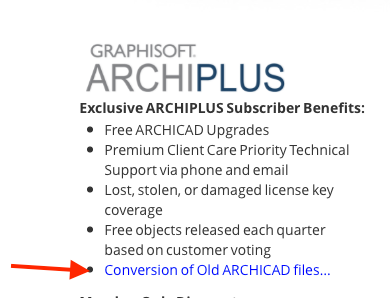

ArchiPlus membership?
archiplus.graphisoftus.com/archiplus_home.html
