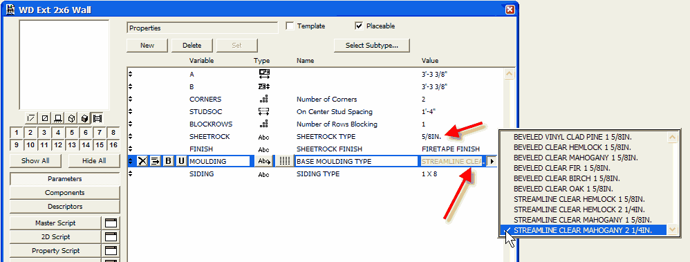

Continuing from the last post, open the WD Ext 2x6 Wall object.
Look at the Parameters, and in particular at the BASE MOULDING TYPE as shown in the screenshot.
If any of you have tried this object, which seems unchanged since 6.5, you have gotten a material list that shows clear mahogany baseboard. Not many of us in the US use clear mahogany there! 😉
The 5/8" GYP is very often 1/2" these days. Etc.
You can change the parameters of this object and save it as a new name (in your project or company library), without doing any GDL coding, and associate the new object with walls to get the revised take-off information.
