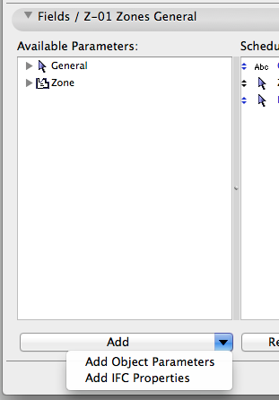

ok, so the answer is no But indeed, those are handy workarounds. In this case I had user defined schedule parameters so I guess they are unfortunately not available as parameters when creating a new schedule or using Find & Select.
Eduardo Rolon
The parameters might be available in the schedule settings though you will need to spend sometime looking for them.

Eduardo Rolon
and then start digging…
